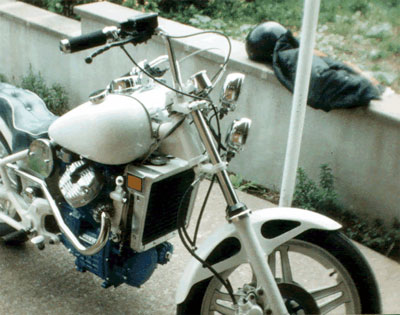

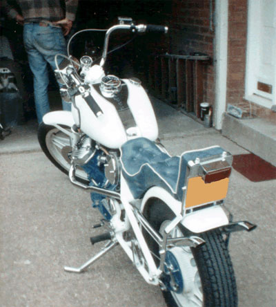

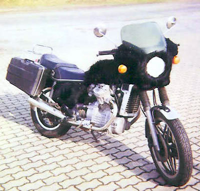

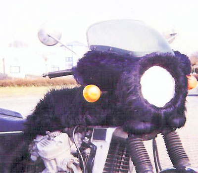

Hi Leute, tolle Website habt Ihr da. Wollte Euch mal meine CX500 zeigen.... wenn Ihr Lust habt könnt Ihr die ersten Bilder von meinem "Plüschprojekt" in Eure Gallerie aufnehmen.
Vielleicht sieht man sich ja mal auf dem ein oder anderem Treffen.
Gruß Steffen "Jack" Ebbers.

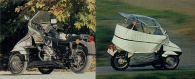

Kijk hier voor meer curiositeiten
Of klik HIER voor meer over de "Quasar Feet forward bike"

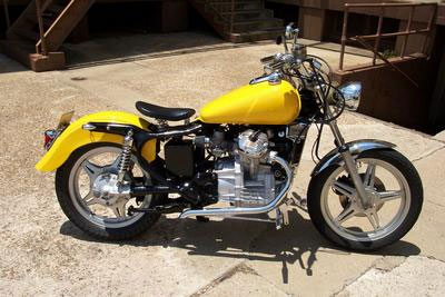

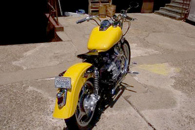

Model: CX 500 DeLuxe
Bouwjaar: 1980

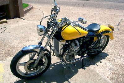

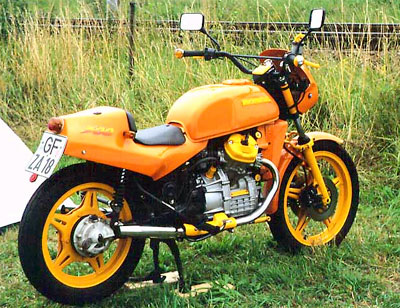

Bijzonderheden: The running gear is, or was, a 1980 CXdeluxe. The tank is from a 2001 Honda Shadow Spirit. The front fender is from a CX650 Custom, the forward controls were fabricated by me. The rear fender is from a Harley Davidson Softail. The tank and rear fender mounts were fabricated by me, as well as the battery holder and cover. The frame was completely disasembled and powdercoated black. The wheels, triple trees, and handlebar switchboxes were powdercoated "Near chrome".
The radiator sidecovers, valve covers, and forward controls were all chromed. The seat is a stock springer solo, 9" wide by about 13" long. The dash is a stock speedo from the Shadow, wired to the harness for the oil, turn, hi beam, and water temp indicators.
The temp sender had to be changed from a gauge to a light switch. I had to modify the electronic sending unit to fit the front wheel for the speedo. The paint is 2003 Ford "Chrome Yellow". I run a "beehive" style taillight used on early HD's and small bullet turn indicators for the back. No signals up front. I fabricated a light bracket for the 6 1/2" front HD style Headlight. All the mods cost about $2500 USD, give or take a couple hundred. I ended up with a clean little 883 sportster killer, with a unique look!
Troy.

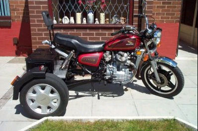

Model: CX 500 Custom
Bouwjaar: 1982
Achteras van een Reliant. Verbouwd naar trike.
Eigenaar: Louise (Blackrose)

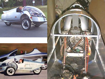

Deze merkwaardige CX is een zg. Feet Forward. FF-F In Engeland is er een levendige scene van deze aparte motoren.
Kijk hier voor meer info
Eigenaar: Royce Creasey

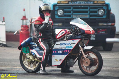

#52 | Geplaatst: 30 okt. 2017 23:17 | Aangepast door: MAST

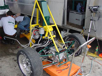

Model: CX 650 Turbo
Bouwjaar: ?

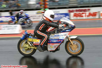

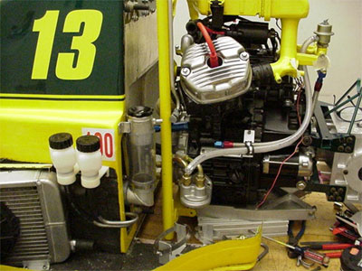

Dragster, turbo/lachgas
Eigenaar: Turbo Tim Boutle
CX650Turbo dragster
CX650Turbo dragster
CX650Turbo Tim
CX650Turbo Tim

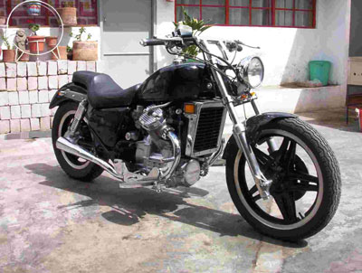

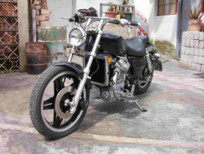

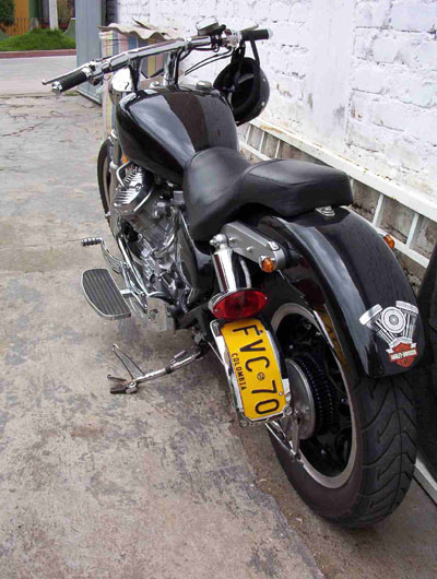

Bouwjaar: 1981
lees hieronder
Eigenaar: Andres
DEAR FRIENDS MOTORCYCLES EXCUSE MY ENGLISH WRITE!
My bike is one cx 500 custom 1981, work in customised 1 year, the parts are make in CALI COLOMBIA SOUTH AMERICAN in SOLO CUSTOM other parts fabricated by me.
The tank and rear fender mounts were fabricated by me, as well as the seat. The frame was completely disasembled and powdercoated black. The rear was expandible 10 centimeters , the pedals are in iron an aluminium
The paint is polurietan glasurit black deep the cost about $2500 USDall bike and remember questions please in Spanish.

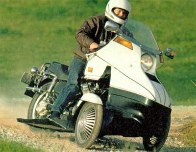

Model: GL 500
Bouwjaar: 1985
Bijzonderheden: Voorkant is de eigenlijke binnenkap van een Polariskuip.

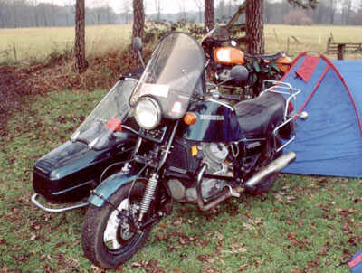

#58 | Geplaatst: 2 nov. 2017 19:36
Model: CX 500
Bouwjaar: onbekend

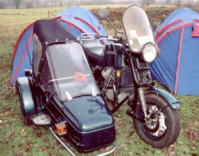

"Ik was laatst op een treffen in Winterswijk. Daar komen vaak Duitse motorrijders naartoe. Dit jaar stond bijgevoegde CX met zijspan op het terrein. Helaas heb ik de eigenaar niet gesproken. De CX leek een gewone 500, met aangepaste voorvork maar ook met grote tank en een schijfrem in het achterwiel."
Is er misschien iemand die meer weet over deze motor of weet wie de eigenaar is?
Stuur even een mail naar info@hondacx500.com
